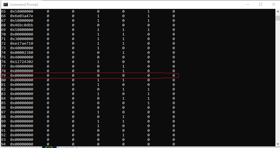

Then I try to test writing a value to wordid 79 which currently is 0x00000000, and free for user.
STM32_Programmer_CLI -c port=usb1 -otp program wordID=0x4F value=0x12345678
No thing wrong, command return sucess:
I display cmd again, it is till 0x00000000, even reset the board.
Any one know what I am missing, please?

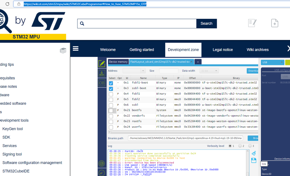

2022-07-28 5:25 AM
Hi @OlivierK
I follow steps from here:
The SDK I downloaded just last week.
The board is STM32MP157F-DK2 - Discovery kit with STM32MP157F MPU - STMicroelectronics

Hi @OlivierK
Hi, the screenshot I capture from wiki that why it is MP157C.
I ran on my PC it was MP157F-DK2 already. I just installed everything from last week. Should are they up to date?

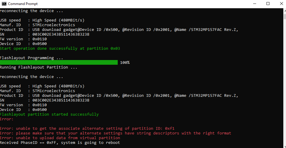

@OlivierK
I tried the command line as your suggest, instead of GUI application, then I got this error, hopefully you will see something wrong in my side.
