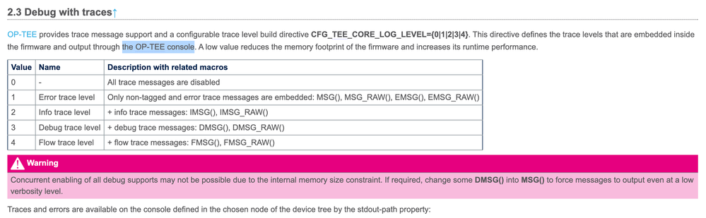

Then, while reading the [How to debug OP-TEE] page on the STM32MP1 Wiki(wiki/How_to_debug_OP-TEE), I realized that the debug log is printed on the OP-TEE console(Marked by the cursor in the attached picture).

Hi @NKim.3
What we call Optee console is the serial link specified as stdout-path in the Device tree
aliases {
serial0 = &uart4;
serial1 = &usart3;
serial2 = &uart7;
chosen {
stdout-path = "serial0:115200n8";
};It's usually Uart4 by default and shared by all BSP component and Linux.
Op-tee trace usually looks like this with [I-D]/TC prefix:
I/TC: Early console on UART#4Hope it help
Olivier
