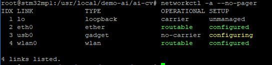

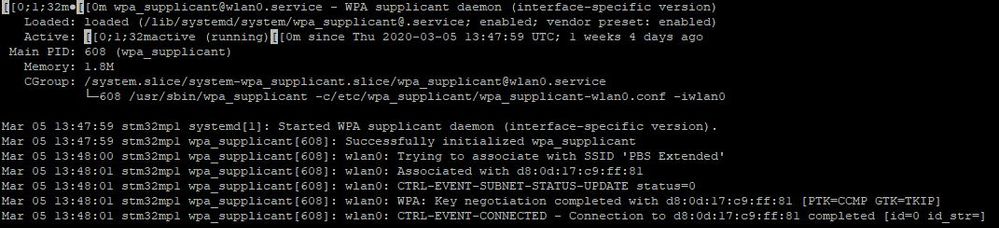

Could you please share results of :
$> networkctl -a --no-pager
and
$> systemctl status wpa_supplicant@wlan0.service
Thanks,
Olivier
2020-03-17 6:15 AM
Following is the result of $> networkctl -a --no-pager:
The output of $> systemctl status wpa_supplicant@wlan0.service is as follow:
