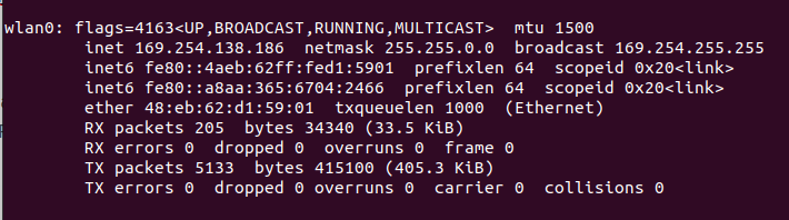

After that, i am able to see the AP when I look in a smartphone, but after logging with the password configured, I see the message "IP configuration failure " on my smartphone.
One thing I see suspicious is the inet when i run the command "ifconfig"

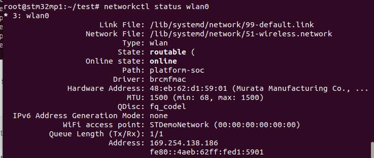

Another thing i see weird is when i run the "networkctl status wlan0" command, specifically the Network File variable

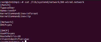

Please also confirm the ecosystem you are using and provide content of /lib/systemd/network/51-wireless.network and /lib/systemd/network/80-wired.network

2023-09-05 10:42 AM - edited 2023-09-05 10:43 AM
Hello @Olivier GALLIEN,
Thank you for your response and willingness to assist. I'd like to provide you with more details about my setup and the issue I'm experiencing:
Configuration: I am attempting to connect other devices, such as my smartphone and PC, wirelessly to a Wi-Fi network generated by the STM32MP157F-DK2. My current setup looks like this:
Access Point (AP): I am configuring the STM32MP157F-DK2 to function as an Access Point, allowing other devices to connect to it wirelessly.
Environment: I am using yocto with the 5.15.67 kernel version in my development environment.
Thank you very much, regards
