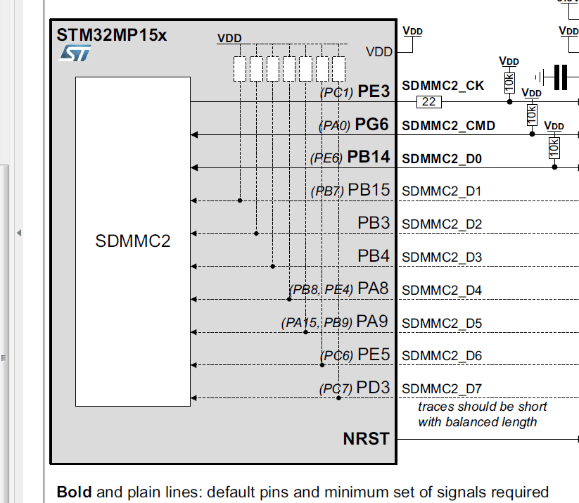

The stm32mp1 use SDMMC2 as default emmc controller. Now, I need use SDMMC1 to connect emmc flash. And I saw the OTP need changed. Bud I am confuse about IOs of SDMMC1. Does it also need setting some OTP bits to pinmux CK, CMD, D0?
This picture show need change bit to chose SDMMC1.
This picture is confused me. When I use SDMMC1, is it need configure CMD, CK,D0 to default pinmux on SDMMC1? If it is needed, where to configure those?

You have already find most information, just missing to set in OTP5-6 the definition of new pins to be used during boot.
In order to use eMMC on SDMMC1 and using (for example) SDMMC1_CK = PC12, SDMMC1_D0 = PC8, SDMMC1_CMD = PD2 pins (only 3 pins used during BootROM first stage of boot), you need to program the following:
You should also update devicetree and rebuild all subsequent level of boot to use SDMMC1 interface and pins (including all eMMC data lines pins , as later stages use 8-bit data mode).
Currently only Toshiba eMMC references presents on STM32MP157x_EV1 boards (THGBMNG5D1LBAIL or THGBMDG5D1LBAIL) are validated with STM32MP1 series.
