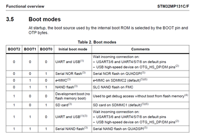

If so, what is the "Serial NOR Flash on QSPI" mentioned in the Boot Mode section of the STM32MP131 Datasheet?

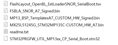

According to the readme.txt file, the source code of the bin file shown in the picture below is said to be requested to ST.
Can I get the code?
