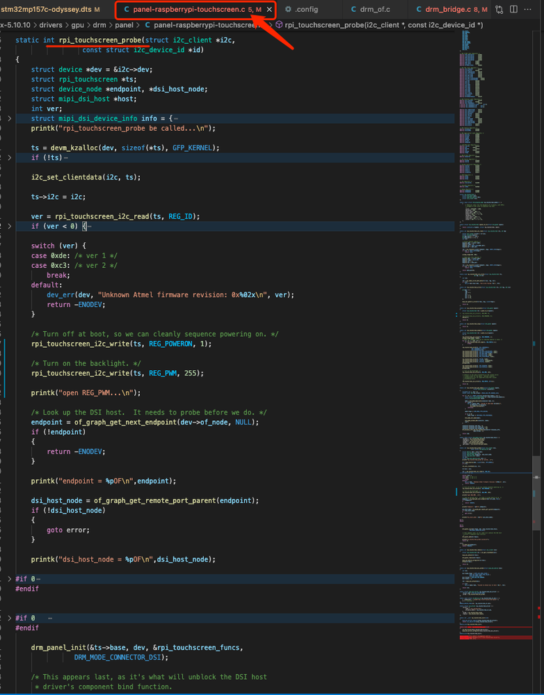

and this is panel-raspberrypi-touchscreen.c ,the touchscreen driver file
