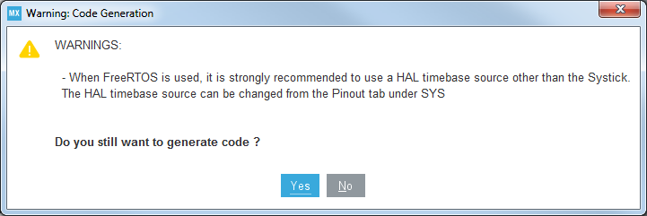

2019-09-05 5:57 AM
Hey, thx for that hint. I'm not using the Systick because of this warning.

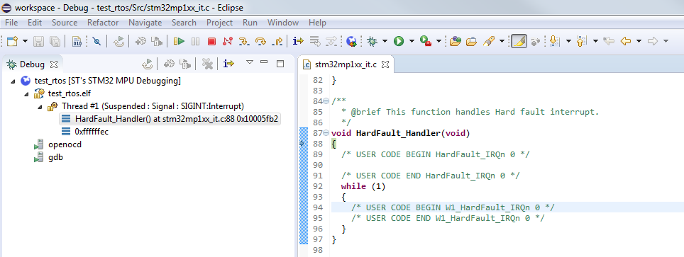

2019-09-26 10:59 PM
Hello Oliver,
unfortunately, the patch can not fix the problem. The firmware with the patch behaves like i described in my last post. With the difference, that it chrashes in the hard fault interrupt. Is the firmware running in your development environment?

2019-09-27 8:09 AM
Hello nrg6 (SAMSON),
I also experience instability issues like you do. The program sometimes run into hard fault the first time when you enter debug probably due to the way openOCD loads the image with FreeRTOS. This point is currenlty under investigations internally.
However, if you try to set a break point in your code, and load it a second time it works for me. Is it the same for you?
Please pay attention to the fact that when you load the image the second time in System Workbench, there is a popup window asking you the following,, ensure you answer "NO".
