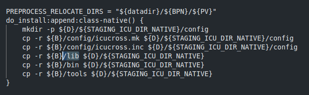

looking at your error message I saw that your package was /usr/lib/lib and I think that is the problem. You should only have /usr/lib.
Try to look your recipe to to ckeck that there is no mistake and you have the same path everywhere.

Hello @Gregory PLANCHON,
I have tried removing the `/lib` from the icu_70.1.bb file, which is the one failing, but it failed with the same error again:That is the only appearance of `/lib` in the recipe. Do you know what I should look for?
