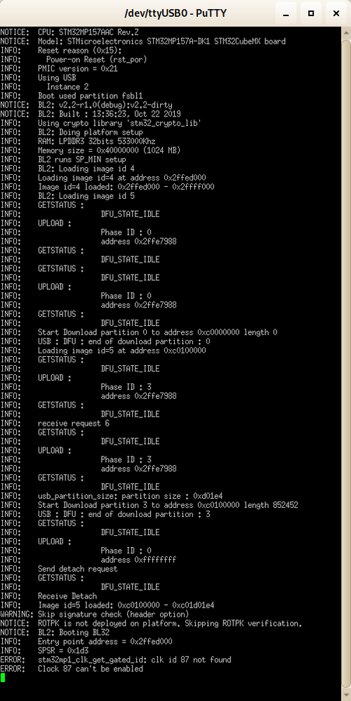

Use Uart to monitor during the download process to get the following information:
NOTICE: CPU: STM32MP157AAC Rev.Z
NOTICE: Model: Thinta TTU Board
INFO: Reset reason (0x15):
INFO: Power-on Reset (rst_por)
INFO PMIC version = 0x21
INFO: Using USB
INFO: Instance 2
INFO: Boot used partition fsbl1
NOTICE: BL2: v2.2-r1.0(debug):v2.2-dirty
NOTICE: BL2: Built : 13:36:23, Oct 22 2019
INFO: Using crypto library 'stm32_crypto_lib'
INFO: BL2: Doing platform setup
INFO: RAM: LPDDR3 8Gb 533MHz v1.45
ERROR: DDR addr bus test: can't access memory @ 0xc0000004I have tried to replace multiple boards. Can you help find the cause of the failure?

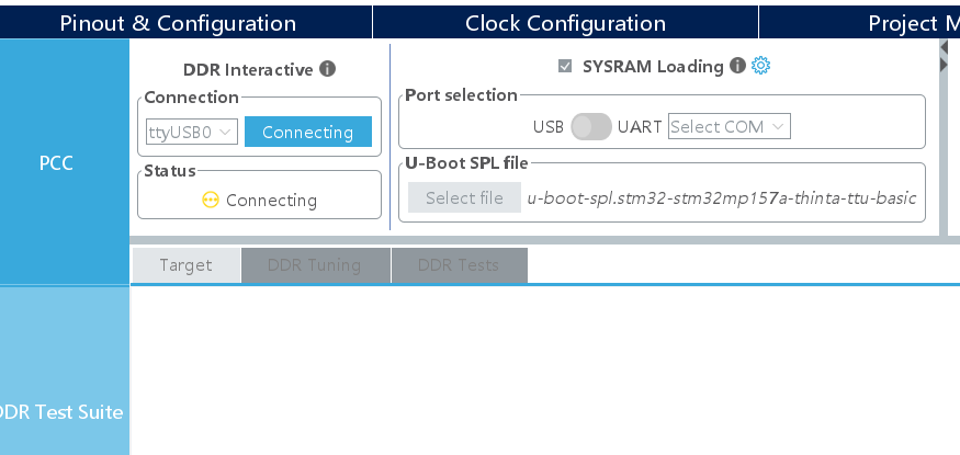

But it can't connect to "DDR Interactive". According to the phenomenon, the U-Boot SPL file has been loaded.
The connection status is always displayed in the interface. Does it mean that there is a problem with the LPDDR3 configuration.

DDR Tool should connect to your board even if LPDDR3 settings are not yet good (u-Boot SPL does not use DDR to start). That's the purpose of the tool.
If you are not able to connect, you could have either a mistake on the UART + USB connection (USB used to download u-BootSPL using DFU, then UART used as main control of u-Boot SPL) or a mistake in your Device Tree making it not starting (of badly starting). You should solve that first.

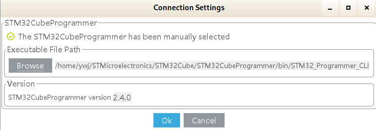

Did you setup the path to CubeProgrammer_CLI (blue config button next to 'SYSRAM Loading") ?
2020-08-03 8:39 PM
Yes, I had setup the path.

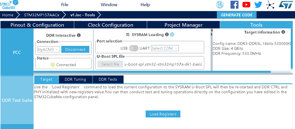

My PC environment is no problem. I have a MP157a-dk1 development board that can be connected to DDR tuning.
If select the U-Boot SPL file I compiled to connect to the MP157a-dk1, the connection status is always been "connecting". So I guess there have some problem with the dts parameter.

Note that If you use STM32MP15-ecosystem-v2.0.0 release, you need to use at least CubeProgrammer v2.5.0.

Now encounter new problems. The debug port returns an error "Clock 87 can't be enabled" during download.
Please refer to the attachment log.7z for the specific log. Please help analyze the possible causes.
