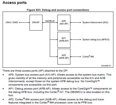

Hi @WSief.1 ,
maybe your debugger does not use the right DAP acces-port.
This ROM table is visible on AHB-AP access-port (AP2) dedicated to Cortex-M4 (and not accessible from AXI-AP (AP0) AXI interconnect as at those addresses there is the DDR).
Tested with Lauterbach Trace32 connected on Cortex-M4, using SWD on a STM32MP157F-EV1 board in Engineering mode (aka Development boot) without any specific settings.
Maybe you could tell your debugger to avoid using ROM table based automated discovery and instead use your debugger 'manual' setup for STM32MP153C which is usually available.
