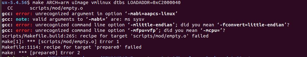

when running make ARCH=arm uImage vmlinux dtbs LOADADDR=0xC2000040
WRAP arch/arm/include/generated/asm/trace_clock.h
WRAP arch/arm/include/generated/asm/simd.h
UPD include/config/kernel.release
UPD include/generated/uapi/linux/version.h
UPD include/generated/utsrelease.h
SYSNR arch/arm/include/generated/asm/unistd-nr.h
GEN arch/arm/include/generated/asm/mach-types.h
SYSTBL arch/arm/include/generated/calls-oabi.S
SYSTBL arch/arm/include/generated/calls-eabi.S
CC scripts/mod/empty.o
gcc: error: unrecognized argument in option ‘-mabi=aapcs-linux’
gcc: note: valid arguments to ‘-mabi=’ are: ms sysv
gcc: error: unrecognized command line option ‘-mlittle-endian’; did you mean ‘-fconvert=little-endian’?
gcc: error: unrecognized command line option ‘-mfpu=vfp’; did you mean ‘-mcpu=’?
scripts/Makefile.build:265: recipe for target 'scripts/mod/empty.o' failed
make[1]: *** [scripts/mod/empty.o] Error 1
Makefile:1110: recipe for target 'prepare0' failed
make: *** [prepare0] Error 2
Thank you by advance for any help.
2020-11-12 4:15 PM
Some think completely broke my SDK install.
The "Hello World" does'nt compile any more.
$CC --version -> unknown command
echo $CROSS_COMPILE -> gives empty string.
I will reinstall the SDK and give you feedback.
Regards
2020-11-12 11:50 PM
Hi @Sisyphus38
Yes you have to proceed carefully to installation of all extra package as mentionned here :
https://wiki.st.com/stm32mpu/wiki/PC_prerequisites#Install_extra_packages
Olivier
2020-11-12 11:51 PM
Hi @Sisyphus38
Open a new shell and source again the SDK.
If one of my comments answer your need, please mark it "Best answer"
Olivier

2020-11-13 1:38 AM
Hello Olivier,
You right. When I source again all env variables are retrieved and the "Hello world" compile again !
I launched make ARCH=arm uImage vmlinux dtbs LOADADDR=0xC2000040 and compiling is still proceeding .
Good signal !
Thank you again Olivier.
