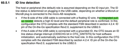

Hello @lingwang
About the first question, according to the reference manual, section 60.5.1 ID line detection, it is clear that it has integrated pull up resistor. It is used to detect when the ID line is left floating (device).
