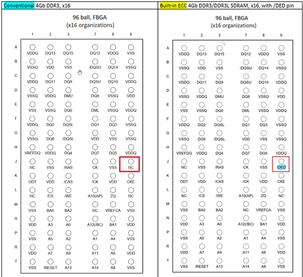

I'd like to comment about ECC DDR3. This device can be used with standard SoC.
Please see below example based on Zentel Japan PN A3T4GF40CBF, 4Gb Built-in ECC DDR3/DDR3L SDRAM:
The ECC is a built-in function, the product has the features listed below

Hi @ABala.7
There is no support of DDR ECC on STM32MP1 products.
