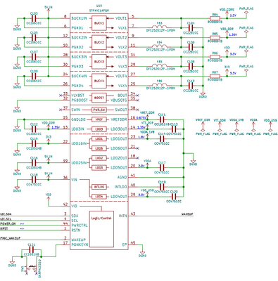

I have attached a schematic of my USB circuit. Please note that I initially had an error where the DP and DM lines were crossed, but this has since been corrected on the board. Despite the fix, the USB port remains unresponsive.

I assume you use STPMIC1A with same supply schema than STM32MP157-DK2.
Did you check various supply presence (especially USB ones) ?
Yes, we are using the STPMIC1A.
Yes, I have confirmed that VDD_USB (3.3V) is being supplied from the STPMIC1A.

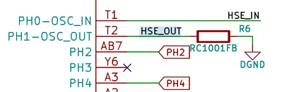

Did you check the 24MHz external oscillator is providing correct digital clock frequency / amplitude and also that OSC_OUT = VSS (for digital bypass detection by bootrom)?

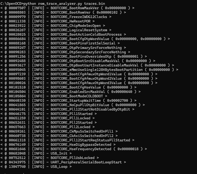

Worth also to check the ROM traces to see if any issues (e.g. boot pins, HSE frequency detection, etc...):
https://wiki.st.com/stm32mpu/wiki/STM32_MPU_ROM_trace_analyzer#ROM_trace_analysis_procedure
I have confirmed that the 24MHz oscillator is outputting the correct frequency. The OSC_OUT pin is pulled down to VSS with a 1kΩ resistor.
I have tried the ROM trace analyzer. The output was identical to the trace from the STM32MP157-DK2 board.
The fact that the ROM trace is identical to the STM32MP157-DK2 makes this issue very confusing.
Given that Windows detects a device but reports an "Unknown USB Device (Port Reset Failed)" error, what could be the potential causes for the DFU port not being recognized correctly at this stage? We are trying to understand what could go wrong between a successful ROM trace and a failed USB enumeration.

2025-10-21 2:05 AM
Hi @mittyan321
I can only repeat to check any differences on schematics you could have between your custom board and the STM32MP157F-DK2 (of STM32MP157D-DK1).
VDD3V3_USBHS, VDDA1V1_REG as well as VDDA1V8_REG should be present (and BYPASS_REG1V8 grounded).
Check possible noise/spurs on all supplies and/or unexpected power sequence (bad component choice around STPMI1A could have dramatic results).
Check if correction of DP/DM swap is ok.
Check DP/DM continuity on the PCB.
Remove all USB protection devices.
Regards.
2025-10-21 6:16 PM
Hi ,
Thank you for all your dedicated support. I'm happy to report that I have finally solved the problem.
It turns out the root cause was a faulty capacitor connected to the VDDA1V1_REG pin.
After I replaced that capacitor, the USB is now properly recognized by my PC.
Your advice to carefully check all the power supply lines was the key to discovering this issue. Thank you again for your invaluable help.
