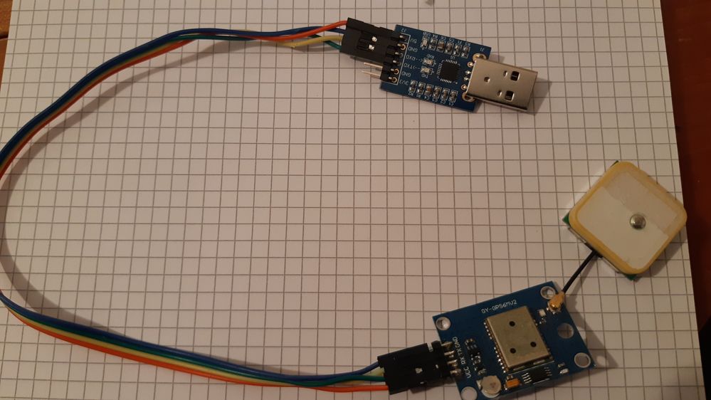

thank for your answer. nevertheless my HW is selected already (see photo attached). My question was mainly to understand the process to install Linux driver on the discovery kit for this USB to serial dongle. thanks (I'm not SW expert)

Hi @jipidi13 ,
CP210x chipset driver is already part of kernel but not enabled by default.
You have to recompile kernel after enabling it. ( You can refer to Developer Package wiki pages for "how to" )
See result of search in make menuconfig :
Symbol: USB_SERIAL_CP210X [=n]
Type : tristate
Prompt: USB CP210x family of UART Bridge Controllers
Location:
-> Device Drivers
-> USB support (USB_SUPPORT [=y])
(1) -> USB Serial Converter support (USB_SERIAL [=n])
Defined at drivers/usb/serial/Kconfig:137
Depends on: USB_SUPPORT [=y] && USB [=y] && USB_SERIAL [=n]
Hope it help
Olivier
