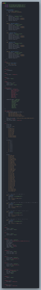

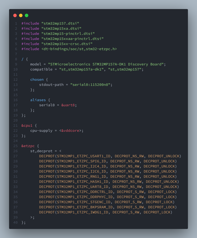

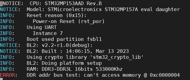

We modified the device tree file corresponding to our development board based on stm32mp157d-ev1.dts.We did not use a PMIC chip, so we added our own power node and modified the default serial port output.This is my device tree file:The following errors will occur during the burning process:
2023-03-20 3:47 AM
The message is quite clear, the DDR cannot be accessed.

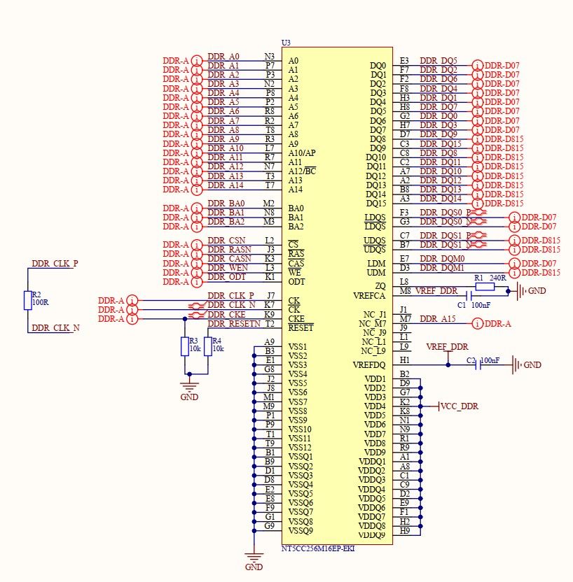

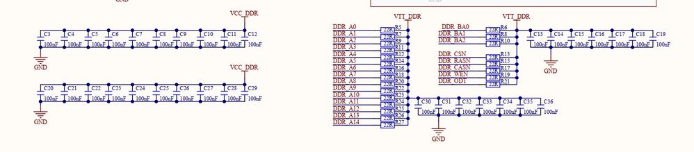

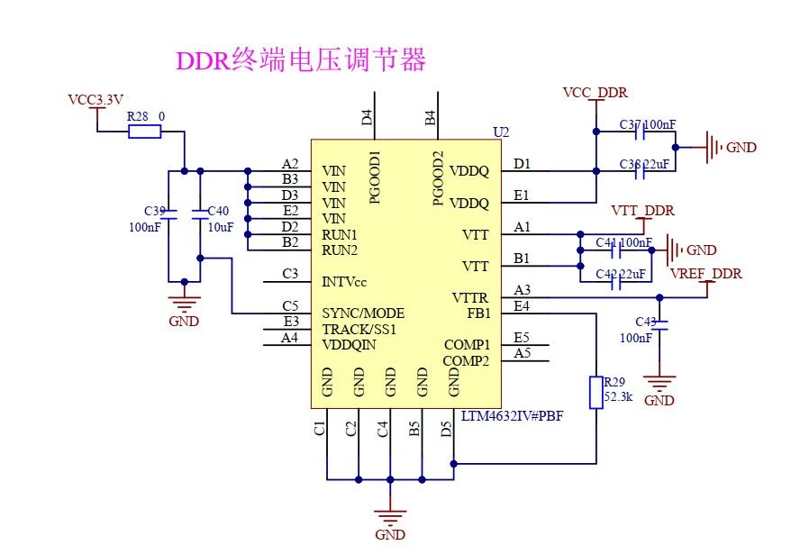

This is my DDR related circuit,the ddr is powered by a ddr voltage regulator.please take a look. Is there any problem?

22 ohms terminations to VTT are likely too low. We recommend 56 ohms.
Maybe not the root cause, but decoupling is light on xxuF range capacitors. e.g. VTT_DDR is maybe missing one or two 10-22uF capacitor close to the memory.
Maybe not an issue, but terminations on DDR_A15 and DDR_CKE are missing.
I did not check the LTM4632 wirings, I assume you have check correct (and not noisy) voltages on VCC_DDR (1.35V or 1.5V) and VTT_DDR/VREF_DDR (VCC_DDR/2).
