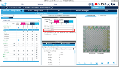

First I changed from 16-Bit density (4 GB RAM) to 8-Bit density (2 GB RAM) and it's working.
INFO: Memory size = 0x80000000 (2048 MB)
