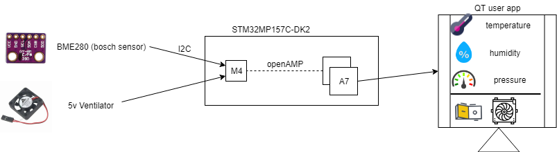

I want to read 3 numerical values (temp,humidity,pressure) from bosch sensor BME280 on the M4 side and send them to A7 side periodically for example every 0.5 second. Then i will print them out to the screen via a QT application on A7 side. User (me) will watch these data on the screen and will be able to send on/off command (0/1) via QT application on A7 for a 5v vantilator which is controlled by M4. M4 will receive this command and turn it on/off.
