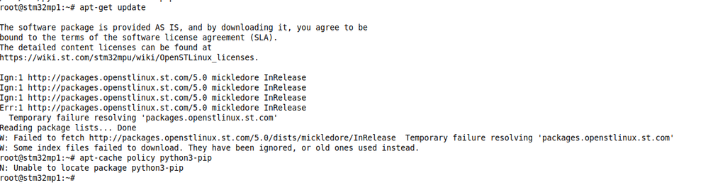

Hi @Softcity
python3-pip is a package provided by our ecosystem.
Could you refresh the apt database and get the python3-pip status with the following commands
root@stm32mp1:~# apt-get update
root@stm32mp1:~# apt-cache policy python3-pip
and gives me the output please?

2024-02-08 4:48 AM
Hi @Softcity ,
Ensure you are connected to internet and the date is set to current time.
See also https://community.st.com/t5/stm32-mpus-products/i-cannot-use-the-pip-command-with-the-starter-package-is-it/m-p/202592/highlight/true#M5991
Regards.
2024-02-08 4:55 AM
ensure you are running the latest Starter Package for your board (use the FlashLayout_sdcard_stm32mp157d-dk1-optee.tsv).
Regards.
2024-02-08 5:35 AM
Thank you for your reply, the same error unable to locate package python3-pip

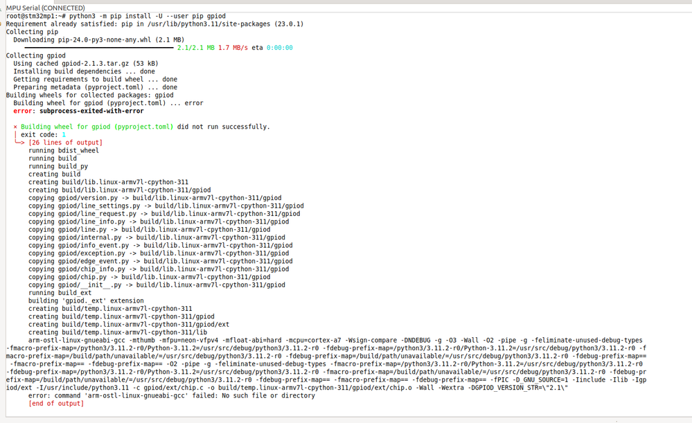

apt-get install python3-pip is working now Thank you , but when I try to install libgpiod i got this error .
Any idea ?

Hi @Softcity
please try
apt-get install python3-gpiod
as a general rule, to know if a package is available with apt-get, you could use
apt-get update
apt-cache search xxxx
