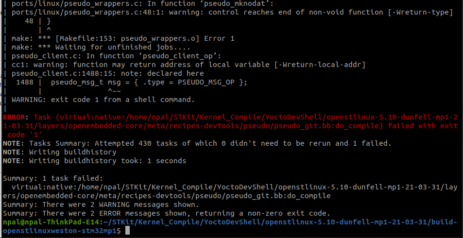

2021-08-12 2:21 AM
2021-08-12 2:44 AM
Hi @NPal.2
I thank you for provindig your log file.
At first glance, I see two items:
IMHO, I think there is some incompatibilities between Ubuntu21.04 and OSTL-3.0 but I am not 100% sure.
Could it be possible to have an access to a machine or a container with Ubuntu20?
Best regards,
--JM
2021-08-12 2:52 AM
Hi @Jean-Marc B : So recently my Ubuntu got upgraded to Ubuntu 21.04. Might also be why i am running into these issues. Is there any timeline when OpenSTLinux is expected to be supported on 21.04. ? Looks like i have to go back to Ubuntu20.04. for now.
2021-08-12 3:11 AM
@NPal.2
Before downgrading your own machine from Ub21 to Ub20, you might give a try by using a virtual machine running Ubuntu20.04.
About the planning for the next supported Ubuntu platforms, I am sorry but I don't have any clue. Anyway, we are relying on Yocto supported linux distributions.
Best regards,
--JM
2021-08-16 4:34 AM
Hi @Jean-Marc B . Downgraded to UB20 . Works like a charm. Thanks for all the patience and support.
