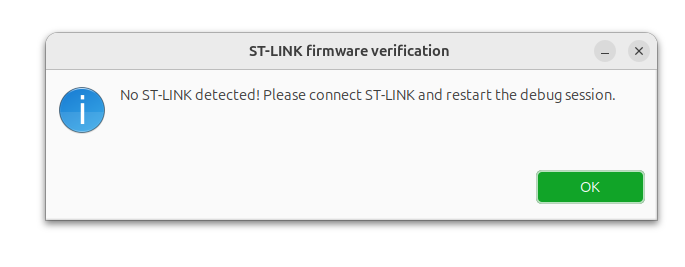

Following the tutorial here, at step 8, I get to the part where you load firmware onto the dev kit, but I always get an error "No ST-Link detected". As far as I am aware, programming should be done over the USB cable, or UART, not ST-Link?

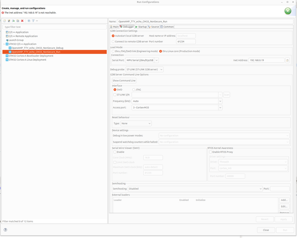

The board is running Linux OK, UART terminal is working, so is IP over USB cable. The run configuration I have is show below. What am I doing wrong?
I checked with STM32CubeProgrammer and there are no programming interfaces available over USB or UART, and no ST-Link..

OK, I worked it out. It seems you do actually need to connect an external ST-Link. I must have missed that part of the tutorial, if it was in there...
