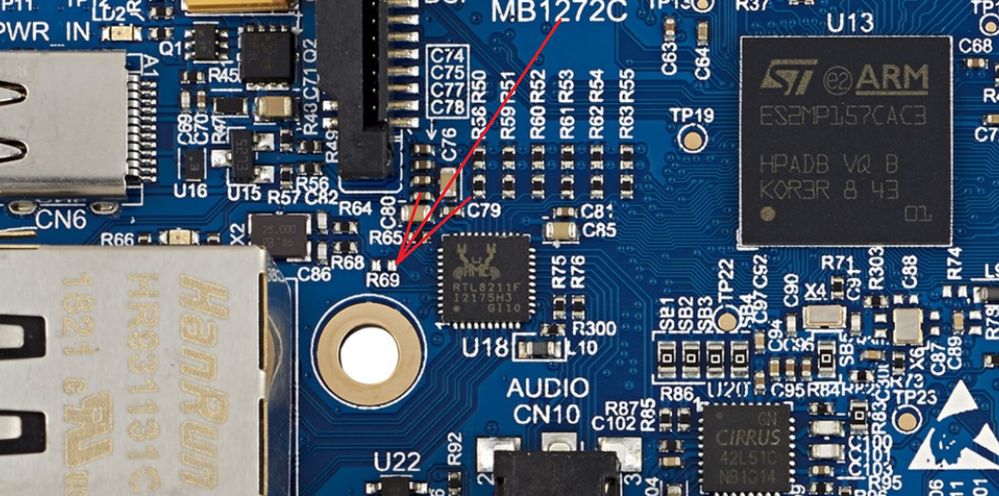

2025-02-05 10:09 PM - edited 2025-02-06 12:03 AM
@xchento use m_can2, I should change pins to m_can2_pins_a ?
m_can2_pins_a included PB13 i PB5 pins. PB13 i on CN2 connector , but PB5, according with documentation:
PB5 is used as ETH_CLK not the default configuration.
How did you deal with it ? Where the PB5 is located on board ?
Are you used below marked place to connect transceiver (PB5 - RX ) ?
2025-02-06 12:53 AM
PB13 and PB12
