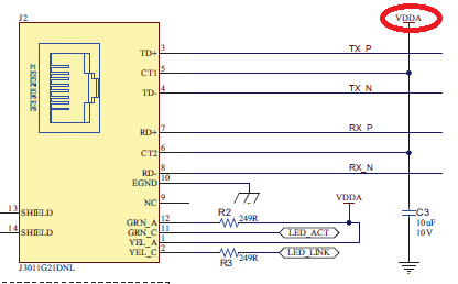

I will include these entries back into the device tree. We just found a hardware wiring problem where we neglected to tie the RJ45 magnetics transformer center taps to VDDA. I have a board being reworked right now and will let you know if this solves our connection problem.

2021-11-16 6:36 AM
Hello Olivier,
Yes, the root cause of the connectivity issue was the missing power connection to the RJ45 magnetics transformer. We have tested and confirmed the PHY is fully functional.
