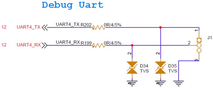

1. Review the schematic and find the debug serial port:

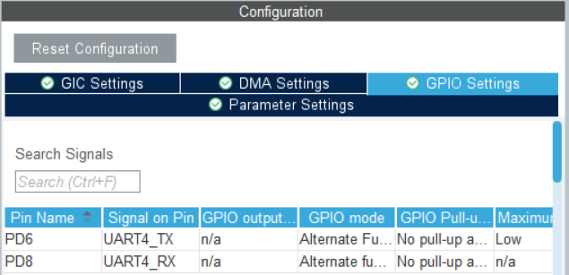

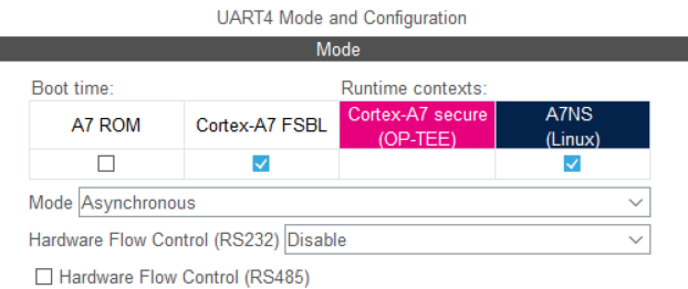

2. Enable UART4, configure the pins and the clock:
Note: The clock for USART4 is using HSI, one reason is to refer to the clock tree configuration of STM32MP135F-DK, and the other reason is to consider the application of serial port wake-up in low-power working mode. Excluding these two points, other clock sources can also be used.

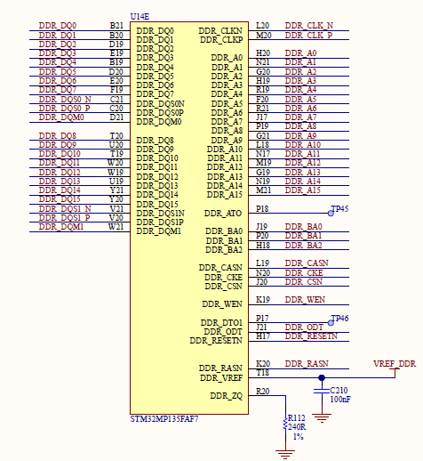

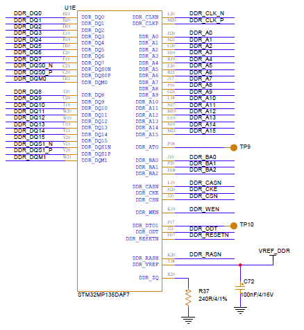

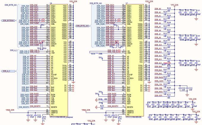

1. Check the schematic diagram of the DDR design section, confirm the size and frequency and other parameters, and complete the design of the DDR part.
Below are some examples of different DDR designs and their corresponding configurations:

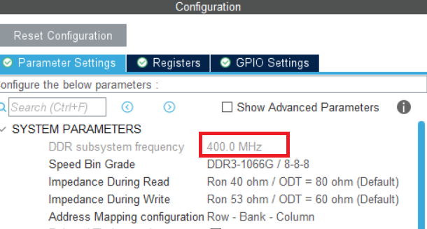

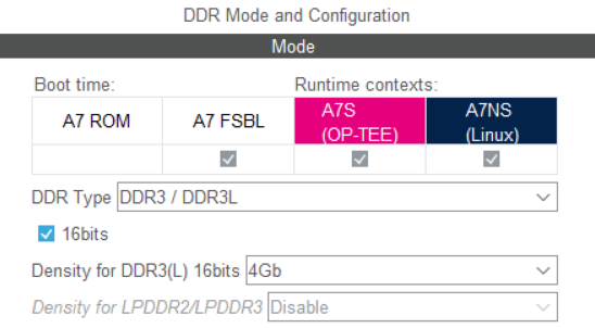

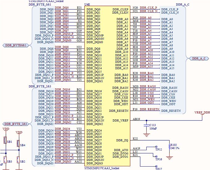

Example 1: STM32MP157C-EV1, two pieces of SDRAM, 32bits, 1GBytes
The DDR frequency can be configured in the Configuration interface.

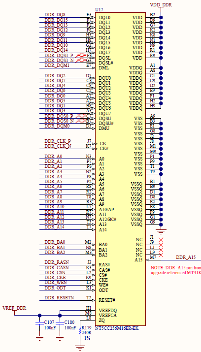

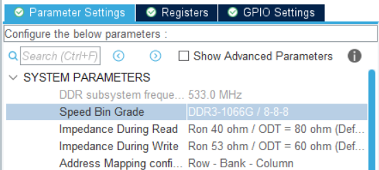

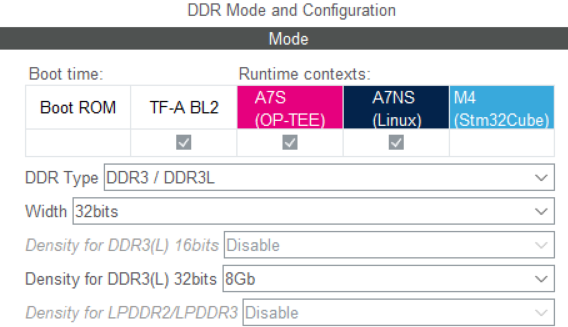

Example 2: STM32MP135F-DK, one piece of SDRAM, 16bits, 512Mbytes.

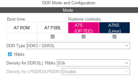

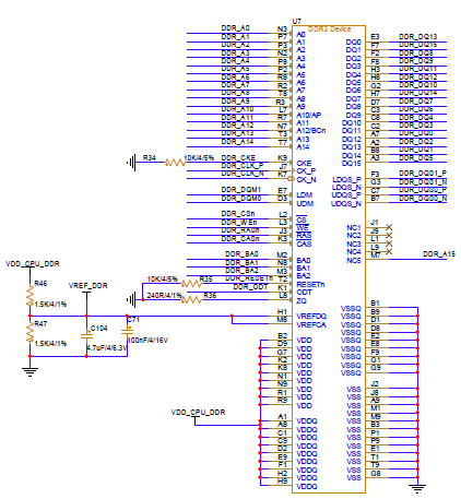

Now let’s take a look at the DDR design part of MYIR’s MYD-YF13X board:
One piece of SDRAM, 16bits, 256Mbytes, STM32CubeMX configured as follows:
