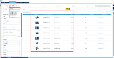

You can use CubeMx for this kind of request. Select Board Selector and write "STM32MP":
These are the available boards for MP products.
Then select a boards and check if it does fit your requirements:

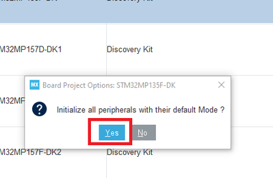

So double click on one board, and click Yes:

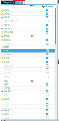

In the "Pinout & Configuration" tab / "A-Z", you will find all the available peripherals that you can use at the same time.

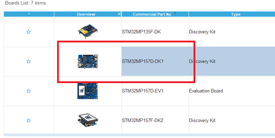

and I think STM32MP157D-DK1 fits your requirements:
For DAC, you need just to fix the conflicts with ADC1 and ADC2 (attached an ioc file).
No WiFi available unless you add a module.

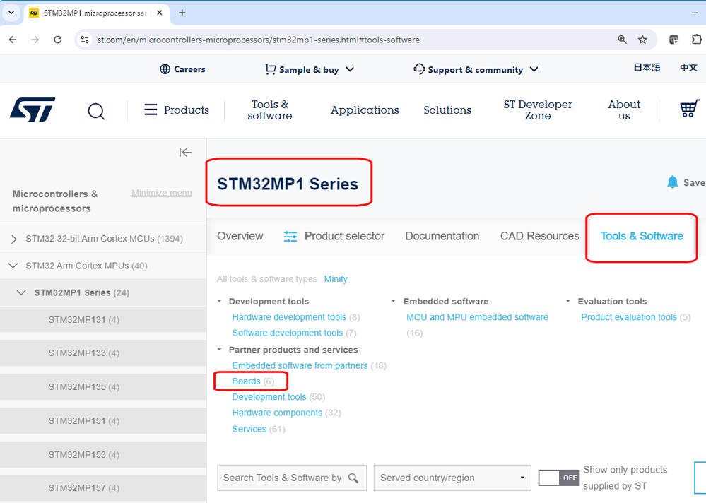

On ST's pages for each of the STM32MPxx Lines you've tagged, go to the 'Tools & Software' tab - there's a link there for available boards:
See which of those meet your requirements ...
