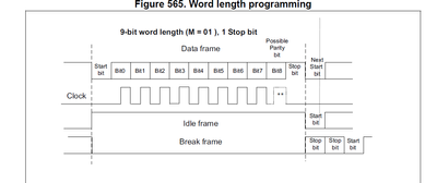

@Kaduru wrote:A Break character (sic) is interpreted on receiving “0”s for a frame period.
A Break condition isn't a character:
A Break condition violates the normal framing - as shown in the diagram, there is no Stop bit.
This is different from receiving a NUL character - which is a valid frame in which all the data bits are zero.
