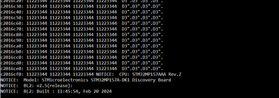

I have attached the screenshot of the output we could see on the console of our custom board
And I have also tried using the STM32MP157D-DK1 and STM32MP157A-DK1 boards.But We are getting the same result in all the 3 boards i.e it resets the CPU .
Hope You could suggest me how to resolve the reset issue
