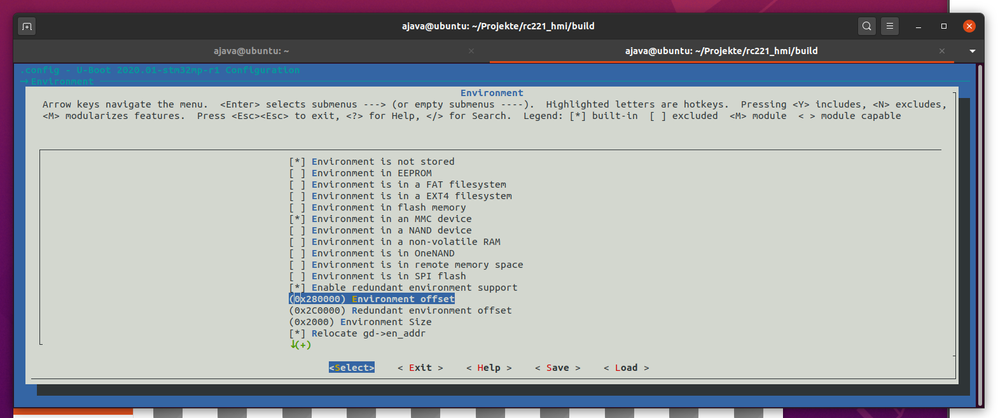

2020-08-03 6:38 AM
@Christophe Guibout
Ok, I am now using the latest release, where "uboot-env" is saved at the end of uboot-image partition (mmcblk0p3).
This relase: https://github.com/STMicroelectronics/u-boot
Regarding the config-file, the env-settings are:
So I configured the "/etc/fw_env.config":
# MTD device name Device offset Env. size Flash sector size
/dev/mmcblk0p3 0x280000 0x2000 0x40000
But unfortunately it is still no working and gives "CRC"-Erorr!
What is going wrong here? Why?
Thanks and Regards
Arash
