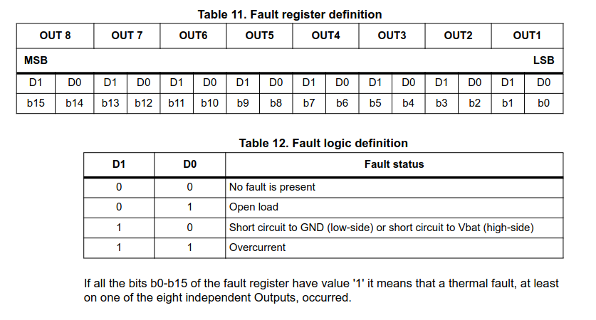

Before launching writing operation to the outputs, I can read the next data chain: 0x55 0x55 0x55 0x55. It indicates that all the outputs (1 to 8 are in open load status. After launching communication (0xAC0F) I read again and obtain: 0x55 0x55 0x00 0x00. It means that no fault is present, but I cannot activate the corresponding outputs. It is not also a hardware issue due I have followed the recommendations at placing 0.1uF on low-side outputs and in Vbat supply.

It may be interesting to review chapter 7, Fault Operation, as the settings in table 9 (0xA3 and 0xAA) can affect the diagnostic data (Fault register, table 11).
