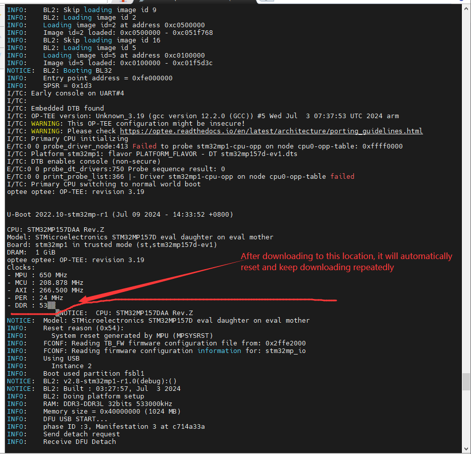

Has anyone encountered this situation before? How should we solve it

Hi @zengyixiang
Hard to solve your issue with few informations.
Maybe linked to DDR issue which mean uBoot crash at some point of time (use STM32DDRFW-UTIL to confirm behavior) . Maybe issue with mixed-up DDR signals (e.g. DQS or DM mixed with DQ bytes lanes) which create trouble as soon as non-32-bits data are needed from DDR.
Any HW issue which could generate a reset (e.g. supply drop, conflicts on signals, etc...) ?
Any memory size issue (i.e. UBoot or else trying to use unavailable DDR memory which could corrupt some other DDR area due to mirroring) ?

2024-07-14 6:04 PM
Thank you, I have identified the issue

2024-07-22 6:12 PM
There is a power supply issue with my board
