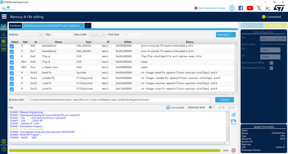

Now I have flashed the board. Is this correct?
I did not get any pop-up that saying "Flash complete"
02:42:03 : STM32CubeProgrammer API v2.17.0 | Windows-64Bits
02:42:10 : Read TSV File: C:\Users\danie\Downloads\stm32mp1-openstlinux-6.1-yocto-mickledore-mpu-v24.06.26\images\stm32mp1\flashlayout_st-image-weston\optee\FlashLayout_emmc_stm32mp157a-ev1-optee.tsv
02:42:10 : Number of partitions: 13
02:43:38 : UR connection mode is defined with the HWrst reset mode
02:43:38 : USB speed : High Speed (480MBit/s)
02:43:38 : Manuf. ID : STMicroelectronics
02:43:38 : Product ID : DFU in HS Mode @Device ID /0x500, @Revision ID /0x0000
02:43:38 : SN : 002600373431510433383938
02:43:38 : DFU protocol: 1.1
02:43:38 : Board : --
02:43:38 : Device ID : 0x0500
02:44:01 : Start Embedded Flashing service
02:44:01 : Memory Programming ...
02:44:01 : Opening and parsing file: tf-a-stm32mp157a-ev1-usb.stm32
02:44:01 : File : tf-a-stm32mp157a-ev1-usb.stm32
02:44:01 : Size : 220.41 KB
02:44:01 : Partition ID : 0x01
02:44:01 : Download in Progress:
02:44:03 : File download complete
02:44:03 : Time elapsed during download operation: 00:00:02.465
02:44:03 : RUNNING Program ...
02:44:03 : PartID: :0x01
If you've followed the steps in the starter package, it should work.
If you don't get a message, your eMMC was not flashed correctly, and as I said above, this is probably due to your hardware modification.
Regards,
Grégory
