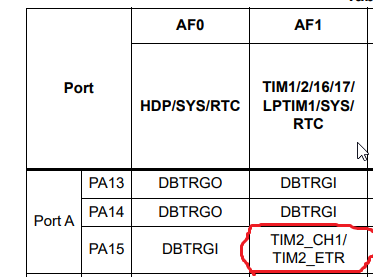

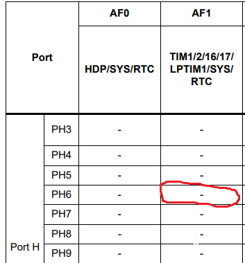

};If you look at the datasheet of the STM32MP157F, page 94: https://www.st.com/resource/en/datasheet/stm32mp157c.pdf
PA15 AF1 is not related to timers 1, but to TIM2
and
PH6 AF1 is not existing:
So it can't work.

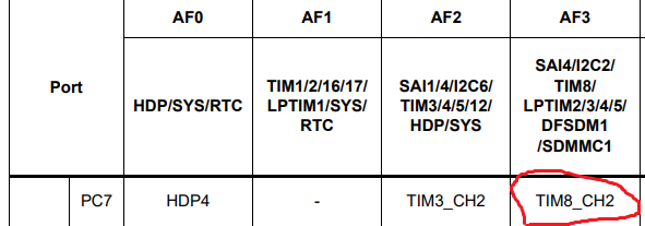

I tested on my 157F-DK2 and as an example, I succeeded to have the content of /sys/class/pwm/ by configuring the timers8.
Since on my board the pin PC7 is available, I added a pwm pinmux into my pinctrl "stm32mp15-pinctrl.dtsi" :
pwm8_pins_b: pwm8-1 {
pins {
pinmux = <STM32_PINMUX('C', 7, AF3)>; /* TIM8_CH2 */
bias-pull-down;
drive-push-pull;
slew-rate = <0>;
pwm8_sleep_pins_b: pwm8-sleep-1 {
pins {
pinmux = <STM32_PINMUX('C', 7, ANALOG)>; /* TIM8_CH2 */
};Because PC7 AF3 is dedicated to TIM8:

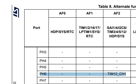

I've only one last question regarding the PH6 pin.
I suppose it's possible to use TIM12_CH1 to PWM the pin? Or am I wrong?
Best regards,
Fernando
2022-01-07 9:13 AM
Hello @FFont.1 ,
Yes, you can use the pin PH6 to use TIM12_CH1 with the PWM.
But if you choose to use this pin, you have to use the timers12 (TIM12)
and specify that you want to use the alternate function 2 (columns AF2 of the array)
<STM32_PINMUX('H', 6, AF2)>; /*TIM12_CH1*/You also have to be careful and verify that the pin PH6 is available and not already used by someone.
