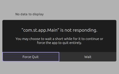

STM32CubeProgrammer does completely crash while trying to connect however...
I'll try the commandline
2025-09-25 1:36 PM - edited 2025-09-25 1:36 PM
Basically the same behaviour with STM32CubeProgrammer_CLI, but it times out gracefully.
