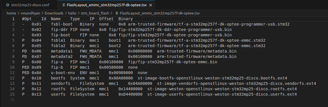

Using a TSV file generated from the build system (same method as reference BSP)
TSV File

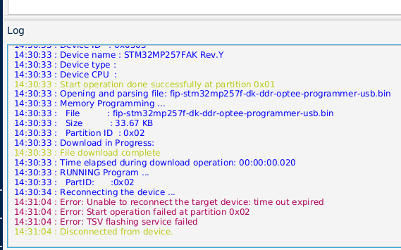

When flashing the eMMC, I consistently get a timeout error in STM32CubeProgrammer.

Hi, there might be two main root causes to look first:
- USB re-connection if you are using a Virtual machine. Check your VM settings or try using CubeProg under W11
- TF-A or uBoot (partition 0x1 or 0x2) is crashing (e.g. DDR init or else), please check board UART console log for error messages.
