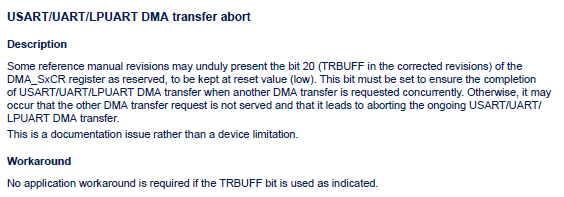

please double check the DMA TRBUFF bit is set when using DMA with UART.
In ES0438 Errata Sheet:

Hi @cfilipescu
seems this is a bug in HAL.
Could you please try adding:
/* USER CODE BEGIN 2 */
(hdma_uart5_rx.Instance)->CR |= 0x00100000;
(hdma_uart5_tx.Instance)->CR |= 0x00100000;
/* USER CODE END 2 */just after MX_DMA_Init();
