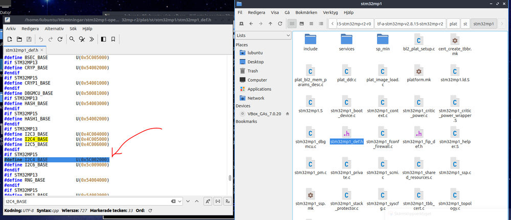

2024-07-23 7:47 AM
I understand. If you don't know more than I do about building own Linux OS for my HW. Then I'm on my own.
Thank you by the way for the answers. They have been very helpful.
I think I will change the pin configuration inside TF-A and recompile it. It must be the only way.
Perhaps Buildroot can compile everything for me at once? I have tried Buildroot before and compile. I did not know what I got back after the compilation. But I did get any errors.
Is it possible to flash a Buildroot compilation with CubeProgrammer?
2024-07-23 8:08 AM
The flashing is usually the latest and the easiest step (if the binaries are running well as flashing is done using TF-A + uBoot tailored for your board).
Yes, either BuildRoot or Yocto could be used to generate binaires (there is more than one, see Flashlayout).

Do you think this number has to do with PZ4 and PZ5 pins? If I change this base address to another base address for the PF14 and PF15 pins. This might work? @PatrickF

So right now I'm compiling the Linux kernel. I'm right here now:
I have placed the file "stm32mp151a-stm32-computer-mx.dts" from the kernel folder, and paste it inside <linux source>/arch/arm/boot/dts folder.
