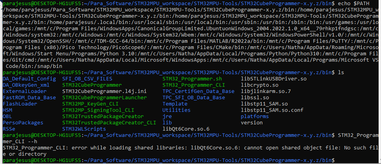

2024-05-15 9:26 AM
Hello @Erwan SZYMANSKI
I am having the same issue. Here are the outputs to the commands you suggested.
Thank you,
Jesus
2024-05-20 2:16 AM
Hello @Jesus5611 ,
In you case, this is not an error of PATH variable content, but more an installation issue. It tells you that libraries for Qt6 are missing.
I advise you to reinstall your tool.
Kind regards,
Erwan.
