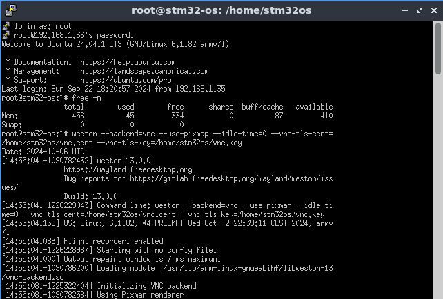

Only run ./create_stm32_os.sh and you will get a file called rootfs.ext4 inside the same folder. Then you can use that .ext4 together with your FlashLayout and flashing your device with STM32CubeProgrammer as usual. The file bootfs.ext4 contains your compiled kernel and .dts file that suits your platform.

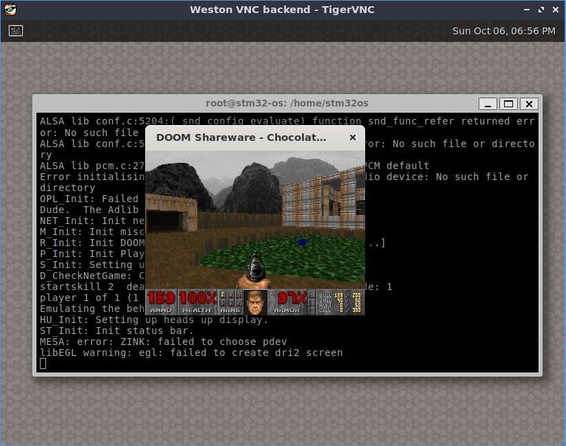

Yes. Playing Doom works on the STM32MP151 processor.
