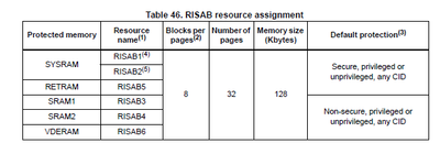

We are testing Memory read and Write in STM32MP257F-DK Board. We are not able to read or write into SRAM1 & SRAM2, but RETRAM and SYSRAM Works. We have enabled SRAM1EN & SRAM2EN in RCC_SRAM1CFGR & RCC_SRAM2CFGR respectively, but read and write of memory doesn't work.

maybe because you are trying to access SRAM1/SRAM2 in secure. Need to change default RISAB settings to your needs.
I think also that depending on boot mode, the BootROM might change default settings as well.
https://wiki.st.com/stm32mpu/wiki/STM32MP2_ROM_code_resource_isolation
I'm not expert on this, you should read reference manual and use CubeMx to define more finely your RIF related settings.

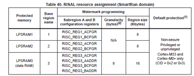

Additionally, we are experiencing similar access issues with LPSRAM1, LPSRAM2, and LPSRAM3. Despite our attempts, read and write operations appear to be blocked.
