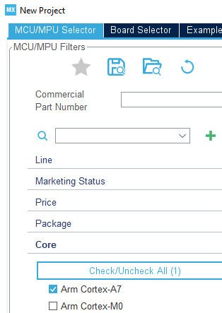

I have no idea about those big processors but i do know how to use the MCU selector from CUBEMX
File>new Project
filter to:
You would need extra hardware for that.

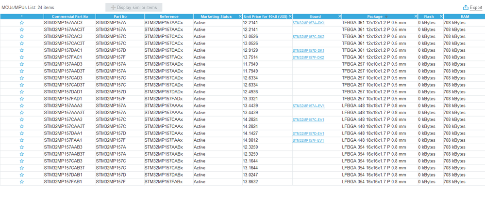

Result:
Infor about camera interface with stm32mp1 https://www.st.com/resource/en/application_note/an5470-stm32mp1-series-interfacing-with-a-mipi-csi2-camera-stmicroelectronics.pdf
