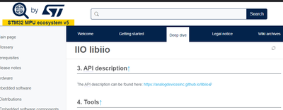

does this page helps ? https://wiki.st.com/stm32mpu/wiki/IIO_overview#libiio

Well ... somewhat.
I found some examples (on other sites) using the sysfs file interface. And since I don't aim for high sample rates and throughputs, I will probably be ok with it.
