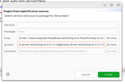

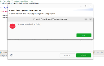

I upgraded to the new development release. I can not create a OpenSTLinux project for my ioc file. I am working with the st32mp157f-dk2 and have installed the new v6.1.0 ecosystem. I have upograde rhw STM32CubeiDE TO V1.19.0.
I set the SDK Root. an loaded the plugins. I have been able to create a user space and trusted applications. However, I can not get the OpenSTLinux project to load.

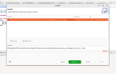

I uninstalled the older version of yocto from my IDE then retried again. I do not get a newer version available.
stm32mp-openstlinux-6.6-yocto-scarthgap-mpu-v25.06.11 is not available.

I'm trying to find the plugin for the June 11, 2025 release for the OpenSTLinux Sources Support.

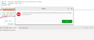

If I try to go back to the old SDK (6.0.0) when I try to setup OpenSTLinux I get this error:
christelle burguera
Hello smanger,
We're managing this issue and will update the plugin ASAP.
Sorry for inconvenience.
At first, I thought is was just the one plug-in. I see that there are more than one plug-in for the old version.
Will these automatically update after they get published? Is there any timeline?
christelle burguera
Hello smanger
if it's for MP1 serie you can now try again, the delivery was done yesterday with a limitation around bootloader on MP13 (see errata wiki page : https://wiki.st.com/stm32mcu/wiki/STM32CubeIDE:STM32CubeIDE_errata_1.19.x or the MPU release note : https://wiki.st.com/stm32mpu/wiki/STM32CubeIDE_release_note for details)
for the MP2 serie, a fix is already ongoing, and we'll deliver as soon as possible.
