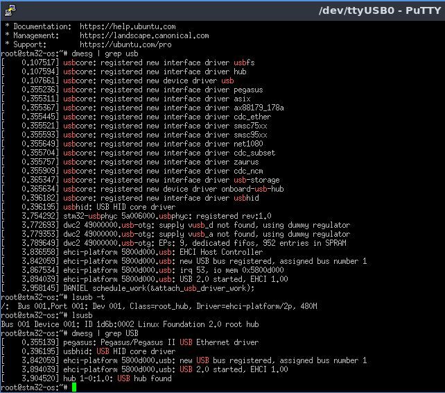

2024-11-18 3:26 AM - edited 2024-11-18 3:48 AM
This is the output when I use this device tree. Note: When I apply 0V on RESET_N, nothing happens. It's like that the hub won't care if I use usbh_ehic. Why? This must be the cause of the problem?

2024-11-18 6:41 AM - edited 2024-11-18 6:42 AM
Hi @PatrickF
I've been using ABM12W-24.0000MHZ-6-D1X-T3 from https://www.mouser.se/ProductDetail/815-12W24-6D1XT
And 6.8 pF caps.
I will measure the frequency and give you a reply later. Perhaps it might be the cause of the failed communication.
2024-11-19 2:11 PM
It was the crystal that caused the problem.
Instead, I made a track from the 24 MHz oscillator, to the USB hub. It works very well. Even my optical mouse was awaken.
