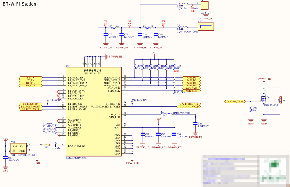

here I have attached the screen-shot of the WiFi section of my custom board schematic
Note: WiFi_BT trigger load trigger MOSFET is short at the moment
