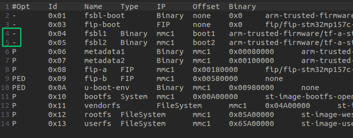

Step 1. The emmc....tsv file modification
Just remove P in lines 4 and 5 and type -. Suggested create a copy of the original file because in next compilation file will be again replaced to the original content.

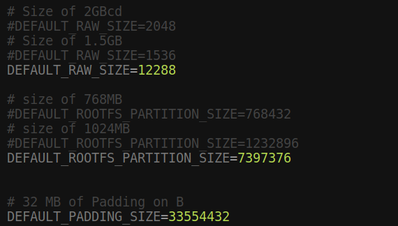

One more thing finally, to be able to store the new prepared *.raw file into /usr/local it is necessary to extend sd-card /usr/local partition. I do it like that in the file create_sdcard_from_flashlayout.sh
but this is only for the Sd-card for the EMMC go back to Your settings.
