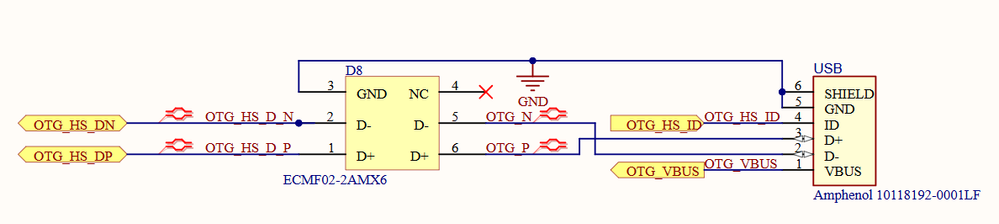

Here is the schematic of the USB. I'm using USB Micro.
This is the configuration of the USB-OTG for U-boot.
&usbotg_hs{
pinctrl-names = "default", "sleep";
pinctrl-0 = <&usb_otg_hs_pins_mx>;
pinctrl-1 = <&usb_otg_hs_sleep_pins_mx>;
status = "okay";
/* USER CODE BEGIN usbotg_hs */
/* This board does not have any USB-C connector */
/* USER CODE END usbotg_hs */
Full configuration here: Configuration U-Boot
