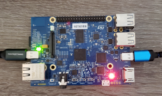

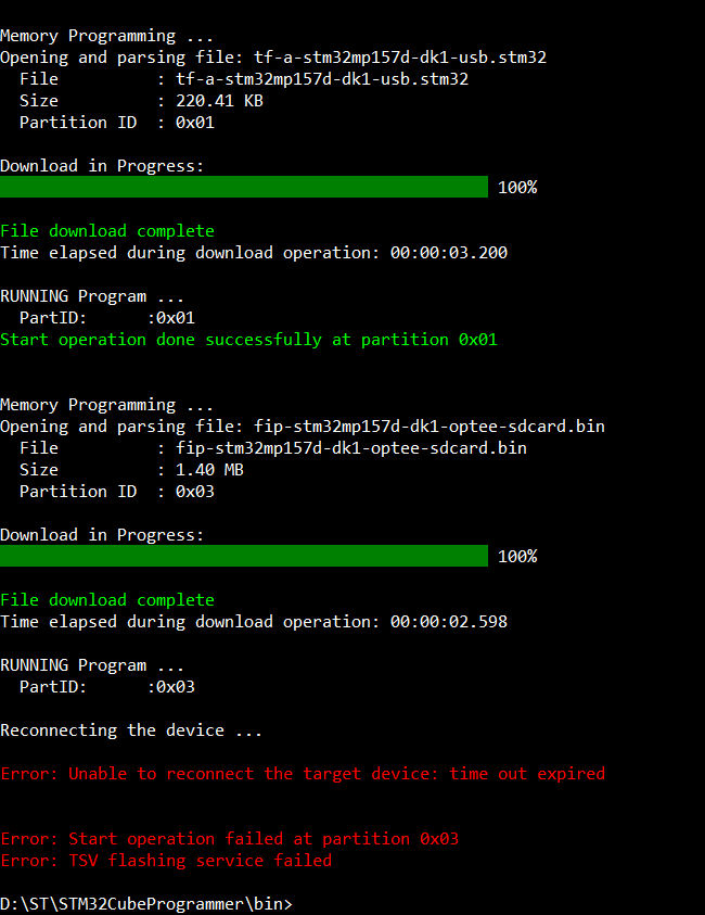

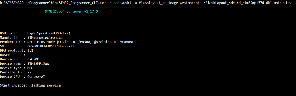

I've been following the STM32MP15 Discovery kits - Starter Package tutorial to set up my STM32MP157D-DK1 board and am having trouble flashing the SD card via the CubeProgrammer CLI. It successfully loads partitions 0x01, 0x03, then the board disconnects and the flash fails.
Here's screenshots of the CLI output as well as a picture of the board:

I had encountered roughly the same problem on my custom board. I don't have a clue for it. After FIP was flashed and target board resetted, the USB device cannot be enumerated by HOST, and STM32CubeProgrammer timed out.
