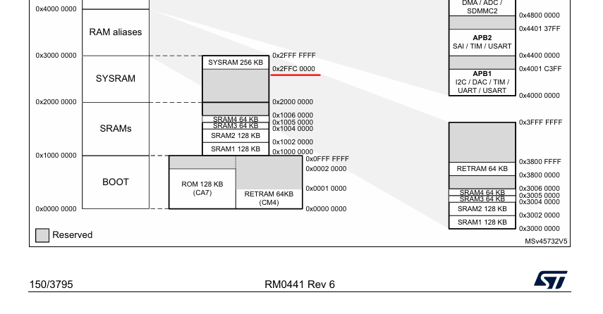

The problem was that SYSRAM did not start. But now it seems that I have made progress.

Hi Patrick! Do you think it's the SYSRAM that causing this code?
I'm sure that it's only a configuration. My I2C peferial did start when I used another .tsv file.
I'm pretty sure that the cause of the error 0x2ffec98b
So what should I do next?

The memory map of ARM Trusted Firmware: 6.34. STMicroelectronics STM32MP1 — Trusted Firmware-A documentation
So that means that It's somthing with Bootloader 2 (BL2).
0x00000000 +-----------------+
| | ROM
0x00020000 +-----------------+
0x2FFC0000 +-----------------+ \
| BL32 DTB | |
0x2FFC5000 +-----------------+ |
| BL32 | |
0x2FFDF000 +-----------------+ |
0x2FFE3000 +-----------------+ |
| BL2 DTB | | Embedded SRAM
0x2FFEA000 +-----------------+ |
| BL2 | |
0x2FFFF000 +-----------------+ |
| SCMI mailbox | |
0x30000000 +-----------------+ /
0x40000000 +-----------------+
| | Devices
0xC0000000 +-----------------+ \
0xC0100000 +-----------------+ |
| BL33 | | Non-secure RAM (DDR)
0xFFFFFFFF +-----------------+ /
What I have done is to change the build artifact for tf-a sources. I have replaced ..=optee-sdcard with ..=optee-usb.
When I'm trying to build the stm32 meta <project name>-mx build artifact. I'm not sure if that's correct.
