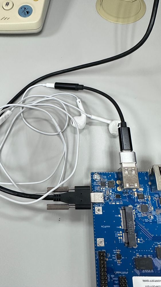

I am a new starter using STM32MPU257F.
I plug a headset into a USB port and use the below command to play an audio-only wav file.
gst-play-1.0 audiofile.wav
the output log as below
[ 240.645711] usb 1-1.2: new full-speed USB device number 3 using ehci-platform
[ 240.864117] input: Synaptics Hi-Res Audio-BY as /devices/platform/soc@0/42080000.rifsc/42080000.rifsc:usb@482e0000/482f0000.usb/us1
[ 240.933975] hid-generic 0003:0572:1B08.0001: input: USB HID v1.11 Device [Synaptics Hi-Res Audio-BY] on usb-482f0000.usb-1.2/input3

but I cannot hear any sound from the headset.
Is it possible to play audio through USB headset microphone?
Are there any settings or configurations required?
